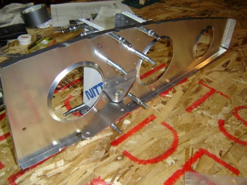

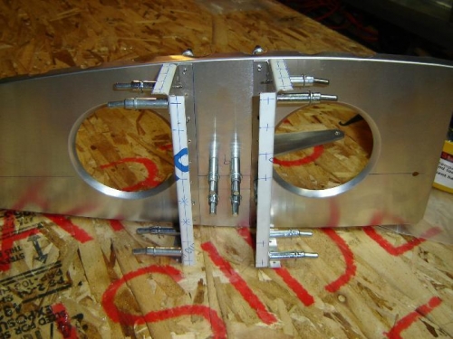

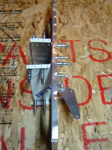

Brief Description:  Right Wing Rib #9
Assemble the parts for the right hand rib #9 aileron bellcrank assembly. This one took half the time of the first one. The photos show it after all the the pilot holes have been drilled. Updrilled, deburred and primed the channels and the contact patch on the rib for the bellcrank.
