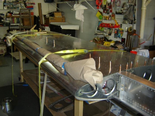

Top side of LE skin riveted in place.

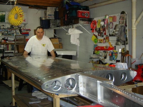

Pulling the LE down to match holes.

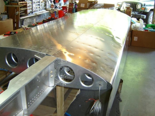

First wing, minus control surfaces complete.
