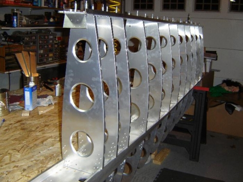

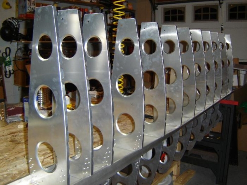

Brief Description:  Prepping left wing ribs
Attached all of the ribs to the main spar then the rear spar. Began fabricating the root rib as well as some of the other spar pieces not included in the angle components kit.
I also cut, finished and match drilled new 0.032 spacers for the ribs. I was not paying attention to my sheet goods and I cut and finished the first set from 0.060 thich sheet. Working late at night causes retreating brain stall.
I first thought the wings would go much quicker since I had the pre-built main spars, angled components kit and the pre-built and drilled ribs, but there are a lot of other parts to fabricate. It feels like it is going too slow, but accuracy is extremely important in this phase so I'm trying to take it slow, measure three or four times before every cut, etc. Hopefully I'll take the lessons learned on the left wing and apply it to the right and speed the process.
