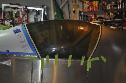

Brief Description:  Canopy Install
Now that it is warmed up considerably, it's time to tackle the canopy. Lots of on and off after each trimming/sanding operation. Every cut makes it fit differently which requires more trimming, but you keep sneaking up on it slowly until it fits.
The cutting takes time the on and off the fuselage is time consuming trying to realign before marking for the next cut, etc.
