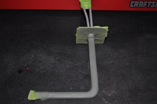

Discovered another builder tip and decided to use it. I ordered the Aircraft Spruce pitot tube. It's simple and very inexpensive but asthetically left much to be desired with it's two tubes brazed together.
The tip I found was to use some JB Weld metal putty to fill the gap between the two tubes. It makes for a much nicer looking pitot tube. I painted it with gray primer after sanding. Much better looking than the original.

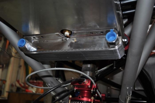

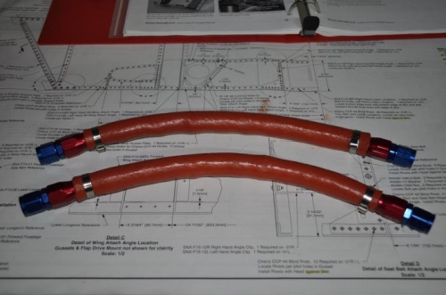

While waiting for the JB Weld to dry I also started mounting the oil cooler and finishing fabricating the oil cooler hoses.
The cooler attaches to a piece of the lower baffle and then to the bottom of the engine between the exhausts pipes. It's very tight fit.
Pitot tube puttied and primed.
Hoses completed
Hoses completed
Very tight fit between the exhausts.
