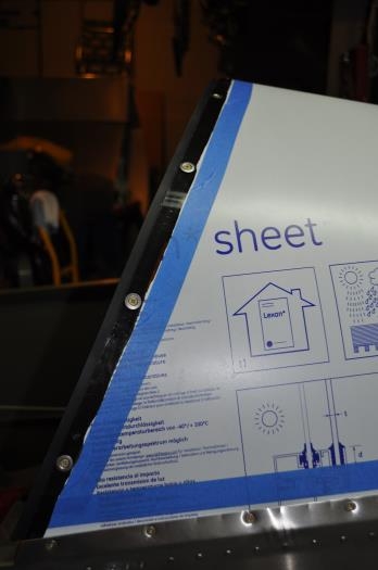

Date:  10-11-2011
Number of Hours:  4.00
Brief Description:  Bolting Windscreen in Place
Final steps to install the windscreen. All holes drilled, countersunk and deburred. Forward bow drilled. This took longer than I thought it would since the screws at the firewall side are very difficult to get to to start a nut. I had to make a long handled tool to hold the nut to get them started as well as a taped on handle to my wrench to tighten.
