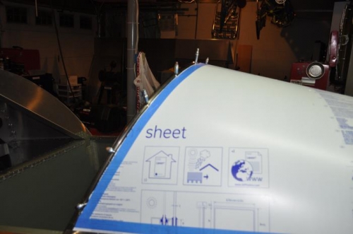

Well, after the move in August it has taken a while with job hunting and unpacking to get back to work.

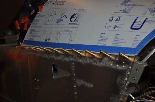

I decided to finish the installation of the windscreen. You need lots of clamps for this particular operation. The front is a bit tricky just as everyone says it is. I thought about adding additional holes to flatten it out along the firewall but decided the gaps were not that big a deal.
Bending the side of the fuselage to match the changing shape of the windscreen was a bit tricky as well. Mine is very "wavy" but I'm hoping once screwed in place a lot of the waves will be taken out.
Drilled and clecoed to the foward bow.
