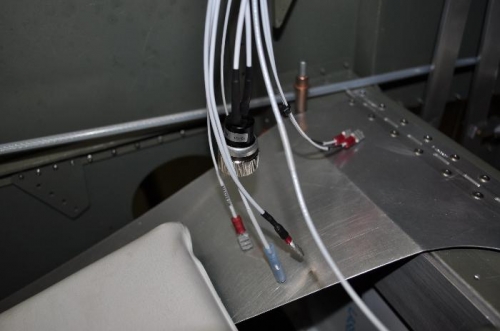

Brief Description:  Wiring the Panel
Continuing to wire the panel. Put my crapping soldering skills into use to solder the starter leads to the switch. It wasn't pretty but it was a good strong joint. The shrink tube covered the ugliness.
Also spending a lot of time to label the wires using the method I used on the firewall side. Small paper labels covered in clear heat shrink tube on each end of each wire.
Next, I'll need to decide on the transponder antenna location, strobe power box, compass and AHARS box locations and backup battery location for the EFIS. All of it, except the transponder antenna, will go under the seat pan,
