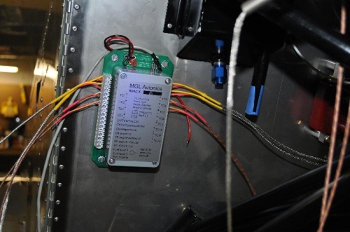

Brief Description:  RDAC Mounting
Once the oil separtor was mounted I moved on to mounting the RDAC box for the Xtreme. I tried to put it as far away from all heat sources as possible. Some builders have built boxes to further shield it from the heat. I'll go with this for now.
Once in place, started routing the CHT and EGT wires to the appropriate terminals.
