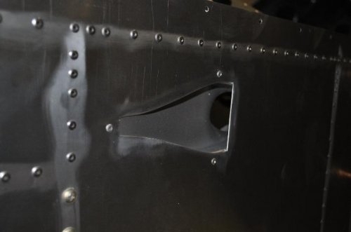

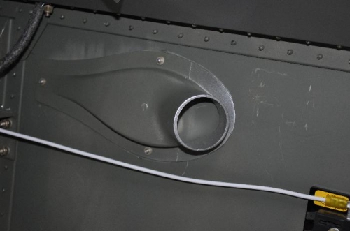

Call me a "Safety Man", but I decided to glue and rivet the NACA vents into place. I used a clear silicone adhesive and three rivets for each. Very solid. I backed up the rivets with a washer to keep from cracking the plastic. Measured and cut the vent hoses but I won't install them until I get the panel and wiring done.
Left side exterior view.
Right side interior view.
