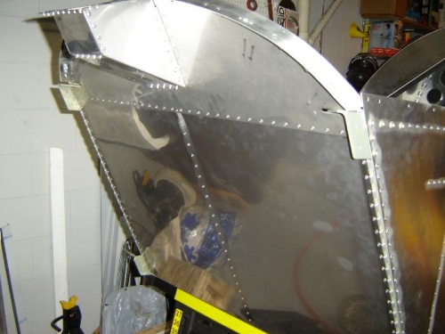

Brief Description:  Mount upper firewall
Now that the interior cockpit parts are in we turned the fuselage upright and mounted the upper firewall. I have refined my stainless steel drilling technique to the point that it goes much quicker. Start with a new cobalt bit, a slower speed with lots of pressure and a liberal amount of liquid Boelube on the bit. As long as you are producing smoke from the Boelube you're OK. No smoke, add more.
