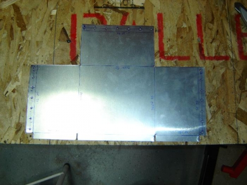

Simple layout on .032 sheet.

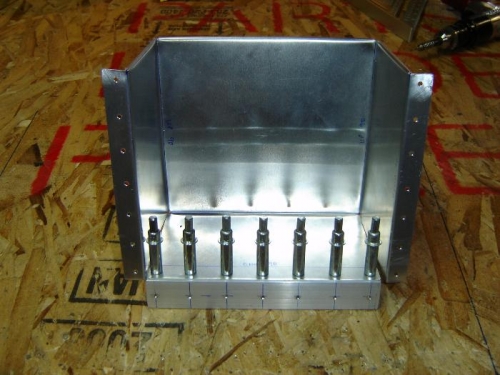

Angle in place.  This will be flush riveted to the box.

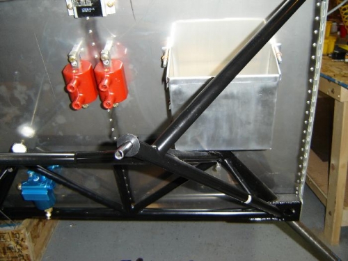

Mounted in place.  The hold down strap will be riveted on after the battery is installed.
