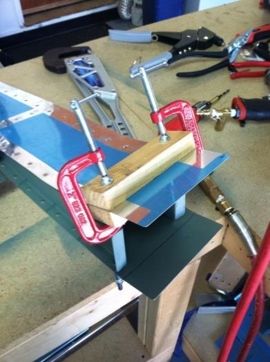

This morning work was slow so I decided to get to work in the garage on finishing up the rudder. I riveted the leading edge and then went onto to bending the forward skin to rivet. I did it without a pipe to roll the edges. Instead I just took my time finessing the amuminum to round it off to set the clecos in. I put a small bend in the skin so when it is riveted it would look like a tight fit.
As of 5/8/2013 the rudder is complete except for the fiberglass. I will do that towards the end of the project so I can install the lighting etc.
Set up the counterbalance weight
