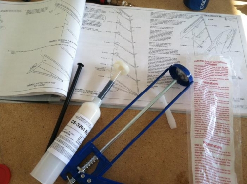

Brief Description:  FInal Riveted Rudder / Leading Edge

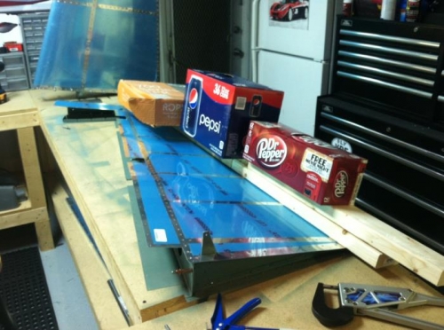

Today after work I started wrapping up the rudder. The proseal arrived from Vans by UPS this afternoon so after dinner I final riveted the rudder frame and then set the leading edge.

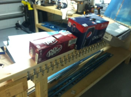

After applying the proseal I cleacoed every hole then weighed down the leading edge so it can set up as per the plans. I will final rivet in a day or two once it sets up.
