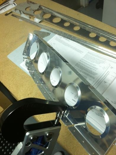

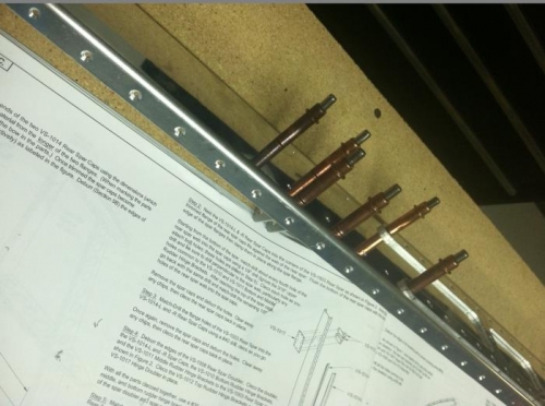

We got in from Church tonight at 8pm. I wanted to tear down the vertical stabilizer since I match drilled it earlier. I started by removing the skin and deburring it. I then machine countersunk the VS spar and then tore down the frame of the vertical stabilizer.
Seems to be going quickly I feel like I have done this before WINK WINK........
Having fun my wife and I deburred the rest of the ribs and dimpled all theparts in preparation for primer and final assembly.
I finished up rather quickly dimpling everything but I havent dimpled the VS Skin yet. I will do that in the morning then scuff, acetone and prime. I have chosen the SEM self etching primer. I picked up two cans Friday and ordered a case which will be here Tuesday. I am hoping to prime the parts in the morning and start riveting some time tomorrow.
Match drilled all the ribs, skins and spars on the VS
Machine countersunk the 1014R & L so the dimple fo the skins fit when it comes time to final rivet
Dimpled all the ribs, spars and started the VS skin. I will finish up tomorrow startpriming and rivet
