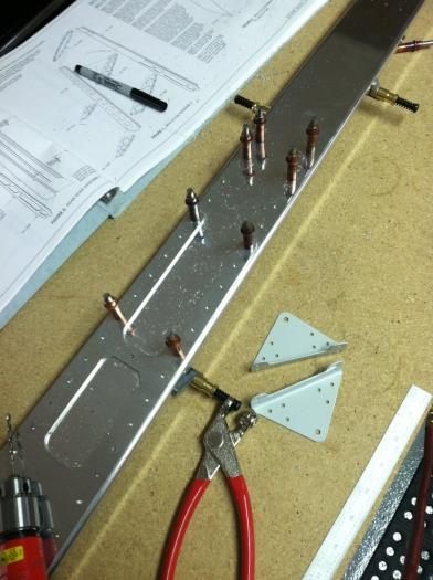

I started with shaping the VS1014 L & 1014 R to fit in the spar doubler for the vertical stabilizer. The first cuts of the kit and it all went well. I then clecoed everything together and once I match drilled with the 1/8th bit I went and machine countersunk #30 across the spar doubler

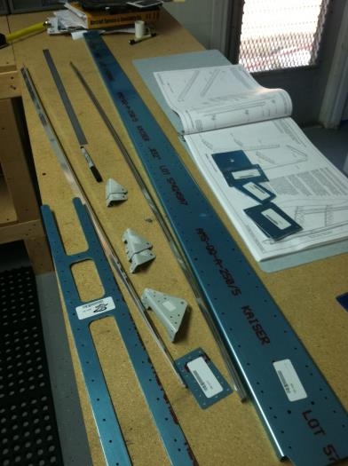

Layed out all the parts for the first section of the vertical stabilizer
Match drilled all the 1/8th holes in the vertical stabilizer spar doubler.
