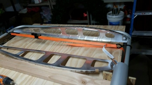

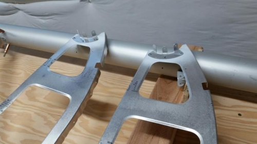

Assembled Ribs.
Rivet clips to 2,3,5,6,7,8,and 10
Cleco clip[s tp spars for ribs 4 and 11
Used tie down strap to bend tip bow to allow tip rib to be riveted
Continue to make more mistakes tha I would like but none that cannot be corrected.
Typically riveting clip to wrong rib and drilling out. Don told me about punching the mandrel ot first
and Jim told me about using oil and slow speed. I'm an expert at drilling them out w/o enlarging the hole. Ordered bunch rivets from Aircraft Spruce and Wicks
