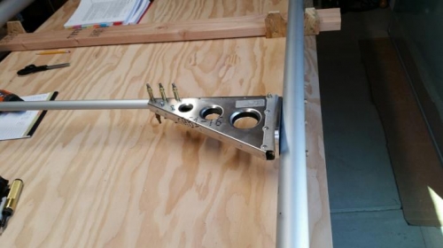

Install Bell Crank Braces
Cut 1" bushings, placed inside Bell Crank Braces, held with JB Weld and spare bolts.
Jim came by taught me that threads should clear parts being fastened so parts are always in contact with smooth shank of bolt.
