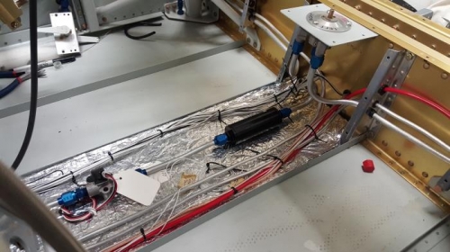

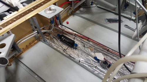

Installed flow meter, filter, and boost pump

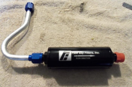

Installed items in tunnel. Filter is 94 micron high flow Flow Ezy filter purchased from Summit Racing. Element is removeable and cleanable
Filter installed downstream of selector valve
Filter and flow meter
