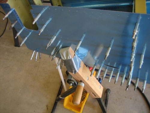

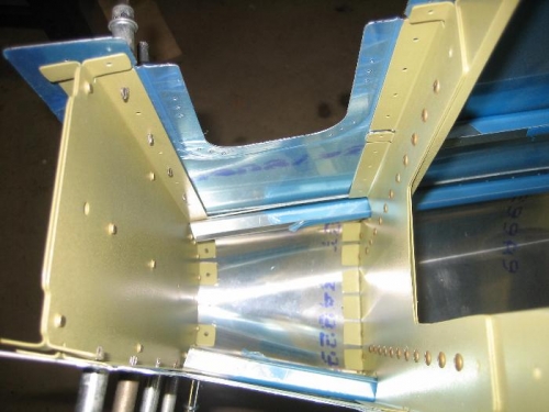

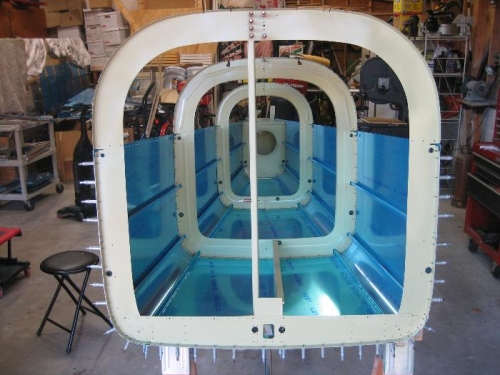

Brief Description:  Tail cone
finally at the point of actually making something to sit in. Spent the weekend working on the tail cone. Clecoed the bulkheads to the bottom skin then attached the stringers. I drew a line down the stringer as described on the plans to allow for drilling the stringer. Overall it went together well. Some slight twist in the aft portion but I was able to correct it without too muck trouble. The fifficult part was trying to bend the small skin on the bottom of 711 and 712. I used a pair of clamps to squeeze the skins enough to get the clecos in for match drilling.
