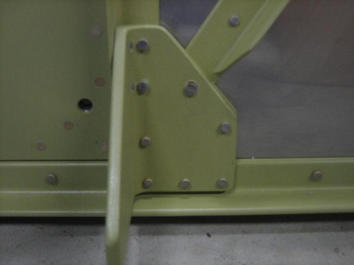

Finished the small details on the firewall. Seems like my riveting skills today have went out the window. Got an enlarged hole in the left lower center firewall bracket. I use a little longer rivet to compensate but the finished shop head is less than desired. Will leave as is for now but loks like I will be drilling out all of the rivets and making a new bracket.

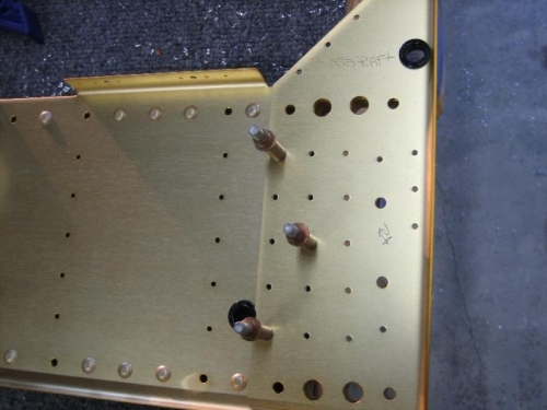

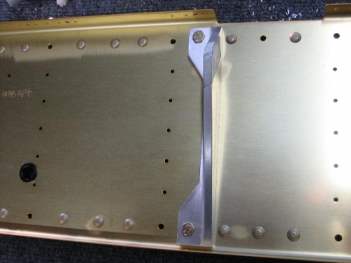

Moved on to the center section spar. Drilling and deburring. Made the control stick support bracket. Came out good using the bandsaw. Will continue tomorrow.
enlarged hole at 2:00
Backdrilling, snap bushings
Control stick bracket
