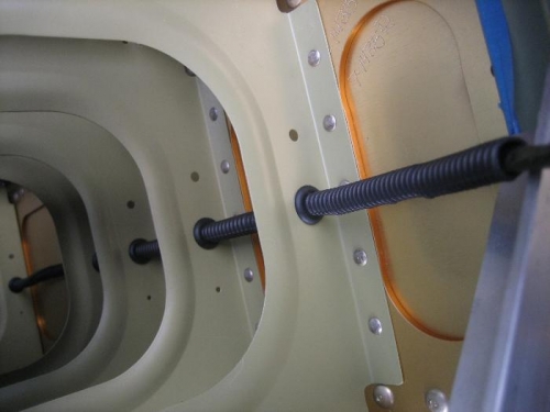

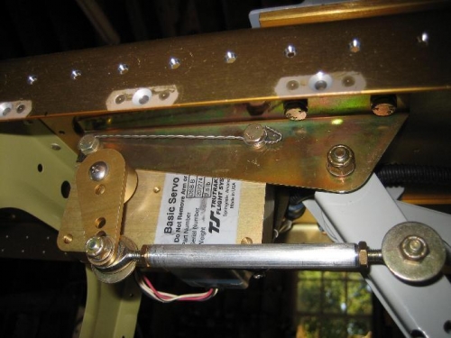

This is actually two days of work into one. The first thing I did was to make up the twisted wiring bundle for the wing servo. That entailed soldering the appropriately sized wire to the female portion of the connector. Afterward I worked on safety wiring the servo to the support brackets and spar. I ran a wiring conduit from the servo to the inboard rib. I ran the wires seperately to insure no interference from the strobe wires to be ran in the large conduit. I used RTV to seal the end of the female plug. I opted to not use the plug cover since with it there was minimal room between the plug and top of the spar. I did not want to have the wire chafing on the top skin rivet shop heads. I needed to cut the plug screws to have then fit into the servo. I only need to get a couple star washers to install screws. I will also use locktight on the threads to insure they will not back out.
Safety wired the servo to the spar bracket.
Dedicated wire conduit for wing servo
Wires attached to the servo
