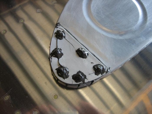

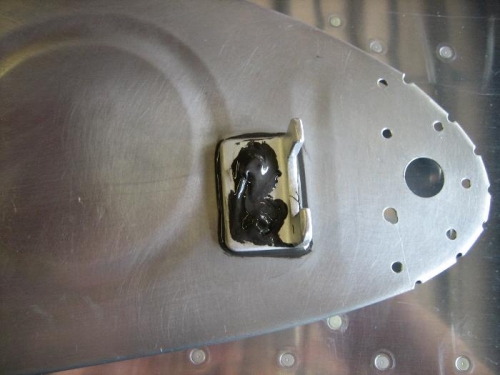

Made enough proseal to not only reinstall the left tenk coverplate but also install parts to the ribs. Since the outboard rib needs a stiffener on the inside of the rib, I went ahead and riveted the stiffener with proseal. Next I installed the flop tube antirotation bracket and finished up by installing a -6 rivet in the outboard rib a tooling hole. That was followed by prosealing the #2 rib flapper door hinge pin in place...to keep it from binding or falling out during installation of the rib. Very messy but Accomplished without too much difficulty.
Outboard rib stiffener
Flop tube antirotation bracket

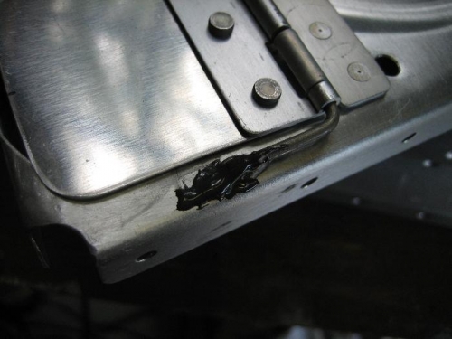

The #2 rib flapper door hinge pin prosealed in place
