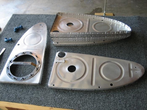

Brief Description:  Readied ribs for installation
Had a few hours to work on the right tank today. since the ribs have been sitting for so long, Decided to get them cleaned and roughened before dimpling. Used a scotchbrite in the alumniprep and cleaned all of the parts. After drying, I sat for a while and dimpled the rib flanges.Will just need to clean the flanges with MEK before applying the proseal. Can't wait for the fun to start.
All clean and ready to goop up

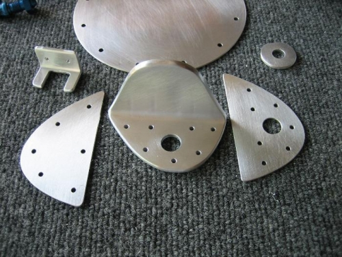

Ribs dimpled and clean

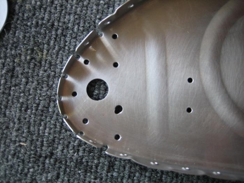

Who would think I would hit the only alligning hole in the nose of the rib.
