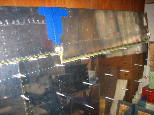

My goal today was to finish the right wing and get it in the rack. To start off, I deburred the skins. Afterward I clecoes them to the wing and reinstalled the Rt flap. while I was at it, I cut the eyelets out of the middle of the flap and installed the hinge pins from the middle. I left them a little long with the intent to trim them at final install. Once the wing was in the rack, I rechecked the aft flap/aileron edge and they were w/in 1/16 of being even. Not too bad!
Rt Flap hinge drilled and installed
Rt flap w/in 1/16 in of being even.
Rt Wing in rack
Rt Wing in rack
