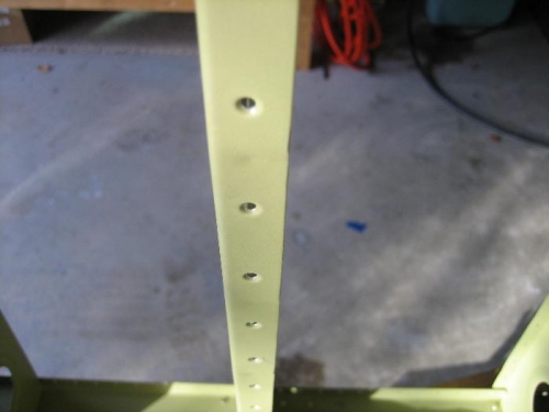

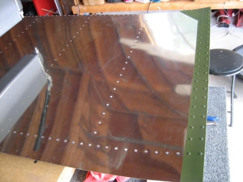

Today was a day for getting the top skins ready for riveting. It took a couple hours to deburr all of the shin and rib holes. Next I dimpled and primed the wing walk stiffener. I then used an electric sander to scarf the anterior overlap of the inboard and outboard skin panels. Afterward I primed the area that was sanded as well as scuffing the overlap area of the skin to allow priming where the skins come together. I never want a metal to metal contact without a primer between it. Now was the time to dimple all of the skins. Mark will be over next week to help in riveting the skins.
Ribs dimpled
Ribs dimpled

Skin dimpled and primed
