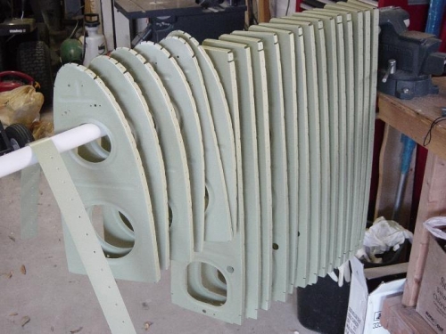

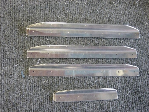

Had a productive day today. Alumapreped the ribs in preparation for priming with Akzo epoxy primer. Decided to prim the leading edge and main wing ribs all at one time. That took just under 1 quart of primer. Overspray is a real problem, since I needed to prime inside the garage due to high winds. The exhaust fan helped to suck the fumes up and out. While waiting for the ribs to cure, I decided to begin on the right tank. cut and finished the tank stiffeners. Drilled the holes for the tank drain and fuel filler. Got late and called it a day.
All ribs primed
All ribs primed

Tank stiffeners cut and deburred
