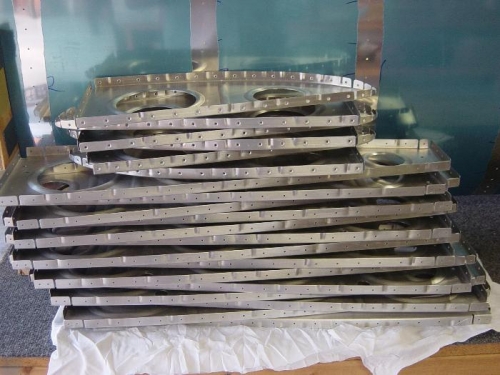

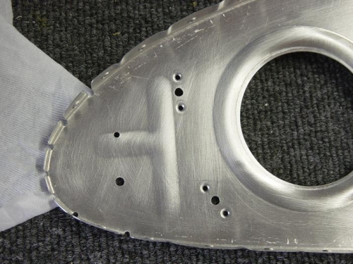

I am taking several days and condencing them into one entry. I have not been able to take pictures of the right wing due to a down camera. I have progressed very slowly in the past few months. I spent the day cleaning the ribs for the wing and leading edge, getting them ready for priming. I have already attached the ribs to the wings and drilled the rivet holes. The main and rear spars were completed when I constructed the left wing, soI am further along then it would seem. I decided to use the Duckworks lights and have taken the plunge and cut the hole in the leading edge. Easier than I thought. The lens bracket holes have been drilled but I will hold off the completion of the light until the ribs and parts anr primed. I drilled and dimpled the attach holes to the outboard and next rib to expedite the installation of the light. Will attach the nutplates after priming. The tank attach strip has been drilled for the leading edge. Will hold off priming until the tank skin is match drilled. Also cut and drilled the wingwalk stiffener.
Many hours of cleaning and deburring ribs, ready for priming
Right wing Duckworks light hole
Outboard leading edge spar drilled for the landing light
