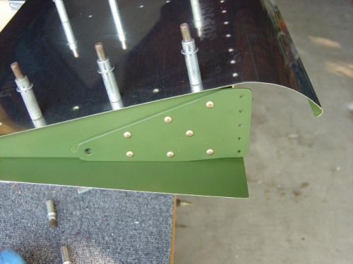

Brief Description:  Constructed left Flap
Since I need to wait for Mark to help me skin the top of the left wing, I will use this time to construct the left Flap. Very straight forward. Very similar to the aileron in preparation. Also used Tempo zinc chromate on the flap inside surfaces. The 6 degree bend for the stiffening plate was a no brainer.
Inside of Flap showing the riveted to the mini spar

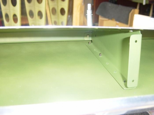

Stiffener plate with nutplare attached to the inside

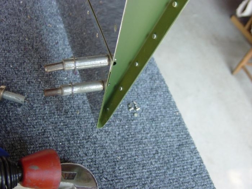

The trailing edge of the flap with the small spacer in place
