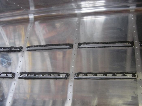

Brief Description:  Tank stiffeners attached

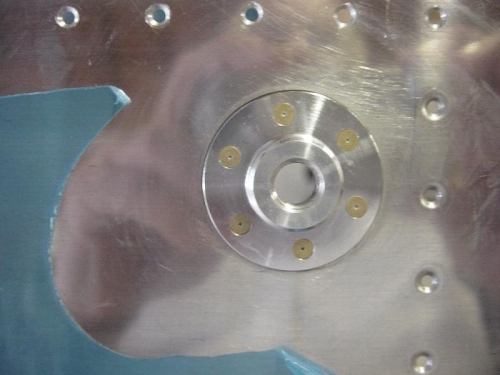

Finally began the process of prosealing the left tank. First I riveted the stiffeners to the skin. The proseal is very messy but workable. TheMEK did a good job with cleanup. The first batch of proseal setup too fast to complete the filer ring and drain so I needed to make a second batch. Did remember to leave spaces between the rivets of the drain to allow for complete draining.
Left Tank stiffeners

Left tank Fuel drain
