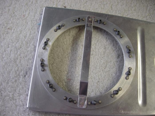

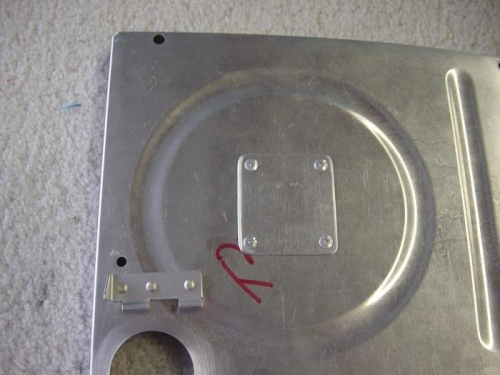

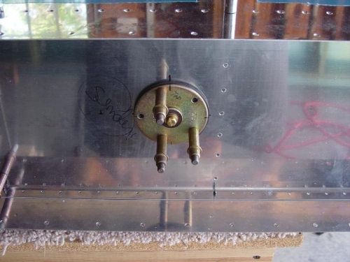

Today I worked on a number of things. Drilled the hole in the rear baffle to attach the fuel sender in the second bay. Riveted the stiffening ring and antihang bracket to the inboard rib. Since I am using the flop tube and the hinged door, I closed the middle lightening hole in the second rib. Note: after reading further in the forum, I decided to remove the cover plate from the 2nd rib lightening hole. Since i don't intend on maintaining a knife edge maneuver, I dont need to have the hole plugged.
Baffle hole for fuel sender
Cover plate attach ring and antihang bracket
Patch for second rib lightening hole
