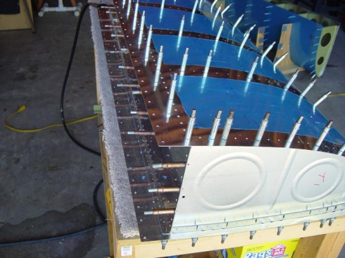

Brief Description:  Left Outboard leading edge
Started the day by back drilling the upper and lower skins to ribs. Clicoed the leading edge skin to the ribs and attached to the forward spar. Straightened and installed the inboard rib, back drilled the flange to the main spar.Inserted the aluminum strip between the skin and the inboard rib to attach the tank. Back drilled all holes to match the skin. Marked the tank Z brackets to have them ready for drilling. On to the fuel tank!
Left leading edge waiting to be dimpled and riveted

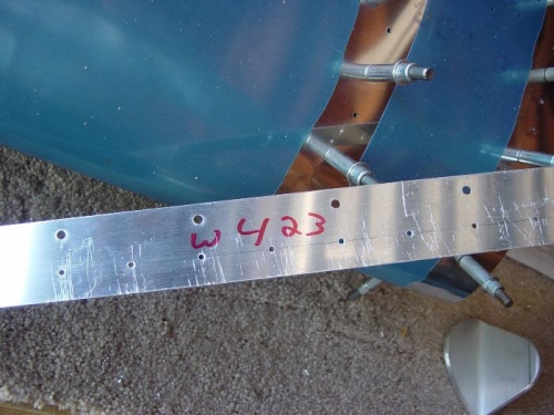

W423 Drilled to both leadinig edge and tank
