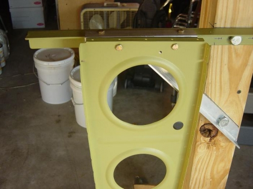

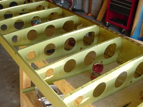

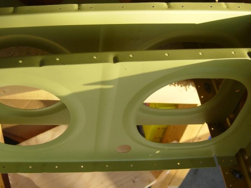

Sat for hours alumnipreping and scotchbriting the left wing ribs. Primed the ribs with epoxy primer. Clecoed the ribs to the main spar and began riveting the ribs to the rear spar.
Inboard rib with hole drilled for the wiring bundle conduit
Primed ribs attached to the main and rear spar
Outboard rib attached to the jig
