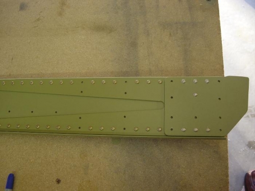

Got up early today to finish the rear spars. Prepared all holes and finished deburring the edges of the spar. Alumnipreped, alodined and primed all parts. Riveted the stiffeners to the spar.
Holes not riveted are for the wing walk ribs and flap brace

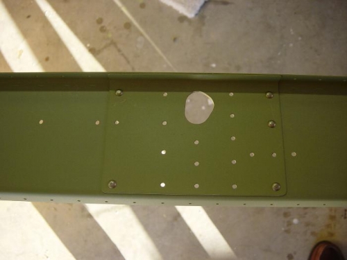

Not many rivets until attaching the aileron bracket and ribs

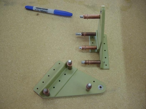

Aileron brackets primed and ready to rivet
