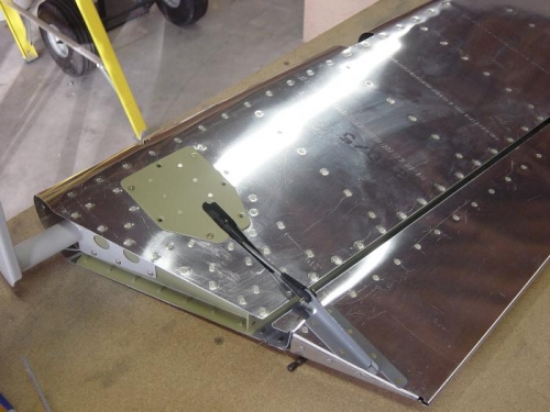

Brief Description:  Completed left elevator

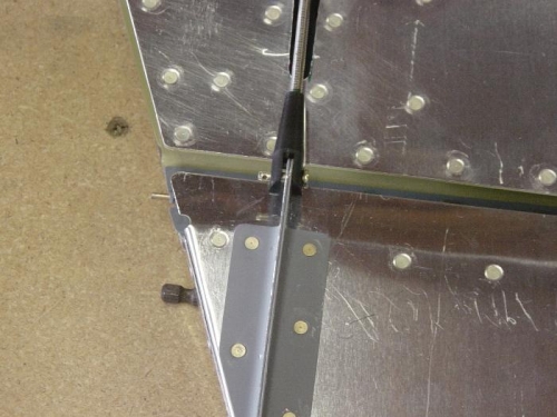

Rolled the leading edge of the left elevator. Repaired mistake on the inboard trim tab. Installed a riblet on the inboard trim tab due to the lack of adequate clearance between the tab and elevator. Completed the electric trim motor. good full travel, but required a lot of work to get clearence for the push rod
Left elevator complete with forward edge rolled

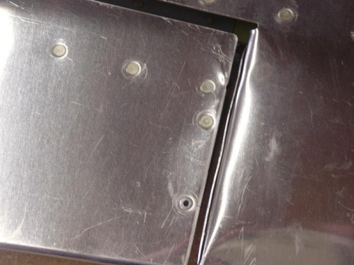

Repair of trim tab to increase clearance
Attached trim motor to left elevator
