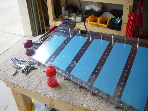

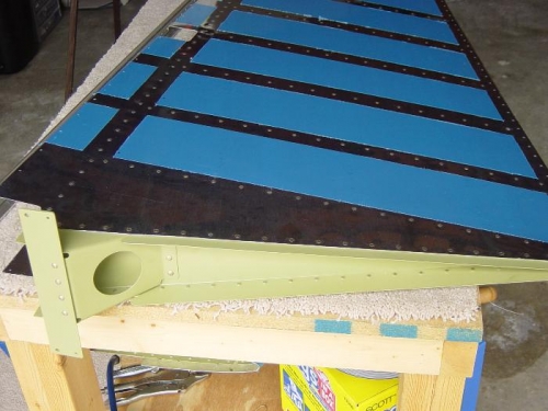

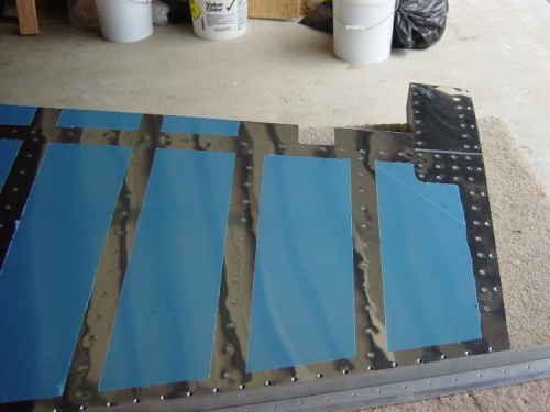

Wanted to complete the rudder today so I can get to the elevators. Used epoxy to secure the trailing edge of the rudder. Very straight once out of the jig. Back riveted per Vans instructions. Was easier and came out better than I had anticipated.
Trailing edge clecoed
Rudder with angle ready to epoxy
Complete rudder except for bending and rivet leading edge
