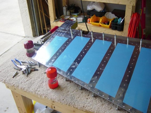

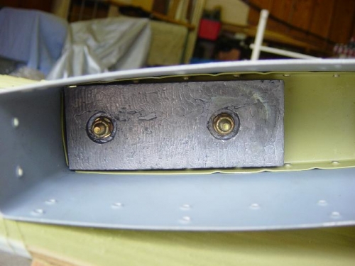

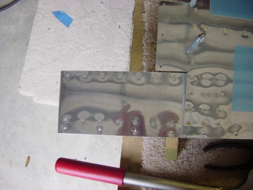

Brief Description:  Riveted rudder skin to skeleton
Riveted the counterbalance skin followed by attaching the lead weight to the counterbalance rib. Needed to trim the weight to get it to fit the rib after the rivets were installed. Hand squeezed the skin to the spar and lower rib. installed the upper counterbalance rib and riveted it in place.
