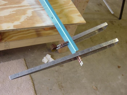

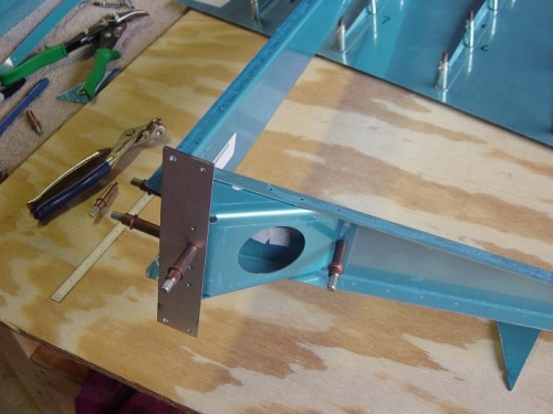

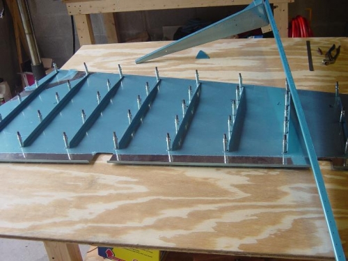

Dry fitted the rudder skeleton, Attached the skins and back drilled all skin and rib holes to #30 and #40 . fluted and squared the upper rib and counterweight ribs. Cut the lower rudder tip brackets.
Rudder Skeleton dry fitting
Skin and skeleton back drilling
Counterbalance rib
