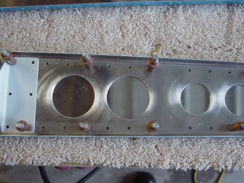

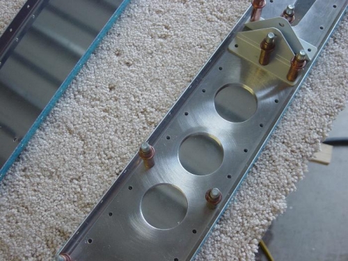

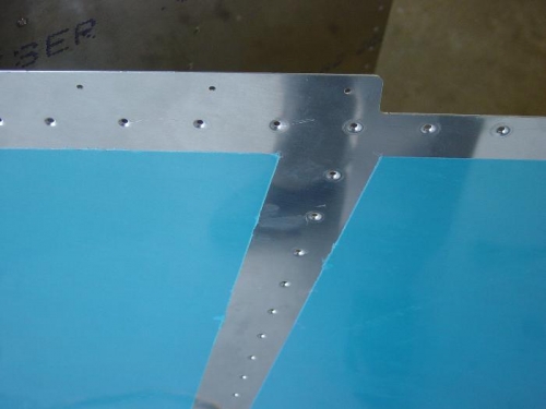

Spent most of the morning cutting the lightening holes in the rear spar stiffener. The flycutter worked well as long as I went slow and used oil. Cleaned up and radiused the stiffener edges and lightening holes. Assembled the skeleton and skin. Back drilled the skin holes to #40. Afterward I deburred and dimpled the skin.
2 inch Lightening holes
1 1/2 inch lightening holes
Dimpled skin
Dimpled skin
