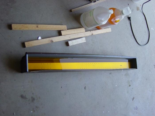

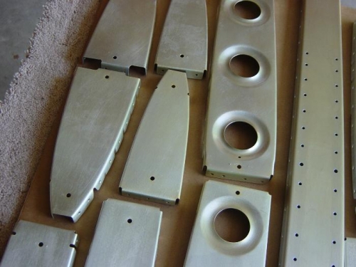

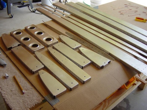

Brief Description:  Conversion for Priming
Alumi-preped and applied alodine to the ribs and spars, getting them ready for priming. Time consuming but it does a good job. Used a scrap piece of gutter for the alodine. Must rember to not get air bubbles under the ribs as it will not convert the metal
Spar in Alodine
Spar in Alodine
Spars and ribs before conversion
Spars and ribs after conversion
