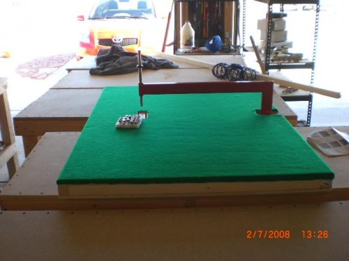

Brief Description:  Manufactured Dimpler Table
Used the remaining plywood from the work tables and a few 2X2's to make a moveable table top around the dimpler so as to help dimple larger pieces of skin. Notice the felt top to help minimize scratching of the metal.
moveable table top for dimpling of larger skin surfaces.
