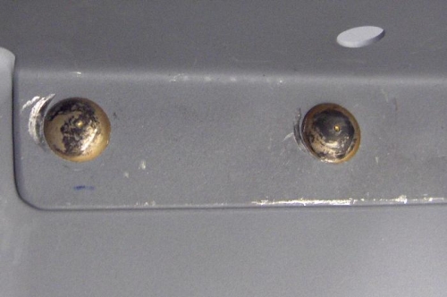

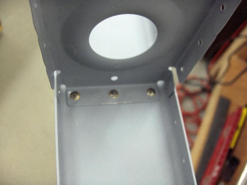

Tried setting 2 of the rivetsin the #4 rib with the squeezer. My troubles with the squeezer continue. The rib laid against the spar pretty well, but after setting the first rivet, there was a gap between the rib and the spar. Same thing happened with the next rivet. Drilled out both rivets to try again. Decided to try the double offset rivet set in the gun, and the tungsten bucking bar. The result was better, gap-wise, but it was pretty ugly otherwise. I have smilies in the rib material on 2 of the rivets. The problem is that the rivet set tends to turn in the gun while it is working, and since it is offset, it takes on an angle as it turns, and you wind up with a smiley. I will let someone look at it, but my suspicion is that I need to order a new rib and try again.
