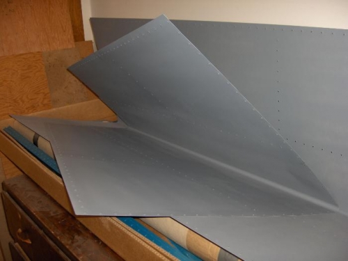

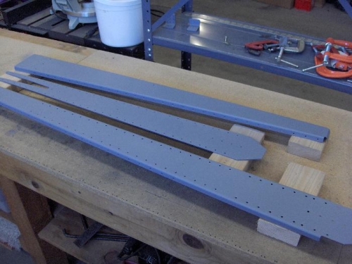

Cleaned and primed the VS parts. Used a small brush to swab a little primer on the inside of the hinge bracket holes. Used NAPA 7220 self-etch primer.

VS skin nested in a HS skin
VS spars & stiffener
