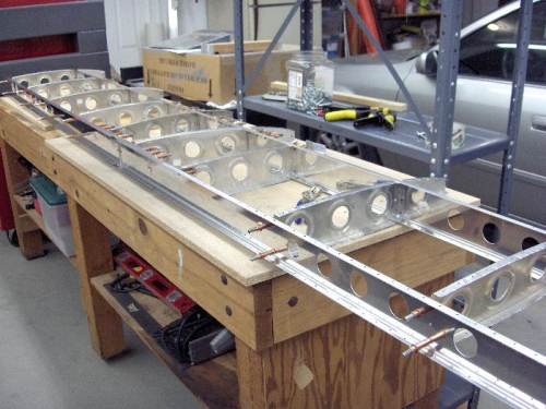

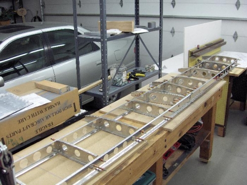

Fabricated HS909 shims and pilot drilled them to the back side of the front spar. Clecoed the HS 904 and HS 905 ribs to the front and rear spars, ready for match drilling the rib flanges to the spars.
