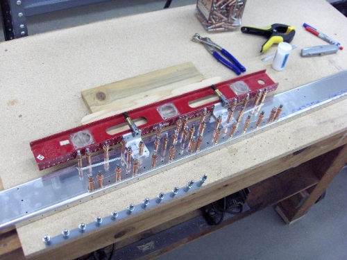

Brief Description:  Match drill HS front spar
Removed plastic from HS front spar doubler and front spars. Match drilled doubler to spars. Clecoed attach angles to front spars and clamped bottoms of angles to a level for a straight edge. Waiting for a new drill bit to drill remaining holes for attach angles in the spars. The holes in the attach angles were initially drilled to 1/8. Will drill holes in spar using the angles holes as guides, to 1/8, and then ream assembly to #30.
