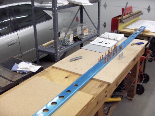

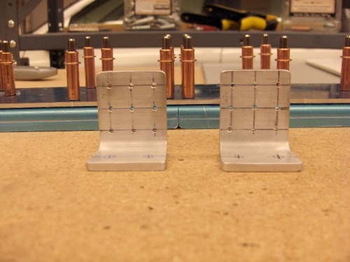

Finished cutting out the HS 908 attach angles. Drilled them to #40. Deburred and smoothed the edges. They still need to be reamed to #30 and given a finish rub with scotch bright to smooth the faces. Clecoed the HS 902 front spars to the 907 doubler.
