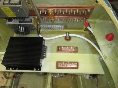

Date:  5-27-2017
Number of Hours:  5.00
I've pretty much finished the power grid, with the mounting of the power converter, and the fabrication and mounting of the 14 volt power and ground busses. Spent a lot of time trying to figure out where all the various avionics components will eventually go. Finally I decided that there will be plenty of real estate on which to mount these items, inclulding the front of the instrument panel. But I did want the power converter and the 14 volt busses near the front, so I found where they would fit best and went for it. I'll finally fit the other components as I can afford to get them.
