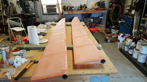

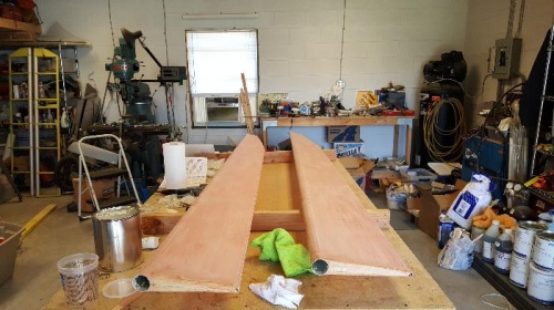

Covered the ailerons, the presewn envelopes were tight! Glues the ends and heat shrank the fabric. Brushed on the first coat of Polyfiber Poly Brush. Let dry and brushed on a second coat of Poly Brush wher the tape will be placed.
Ailerons with fabric shrunk,first coat of Poly Brush
SecCoat of Poly Brush where the tapes go
