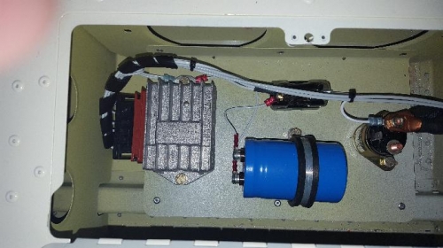

Wired the left side voltage regulator and capacitor. Finished wiring the pilot control stick. Fabricated a new cover plate behind the pilot seat to mount the remote magnatometer for the Skyview. Routed the wiring to the rear Skyview display and shortened a nine pin network wire to connect it.
Left electronics bay
