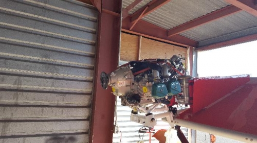

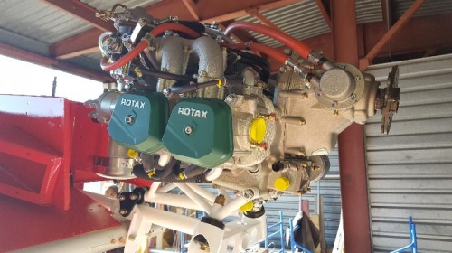

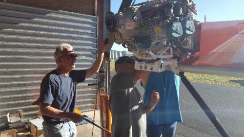

Brief Description:  Mounted the engines
Installed the engine mount frames to the engines. After having a great amount of difficulty trying to insert the AN8 bolts into the motor mount we discovered the holes were undersized. Lukily we found someone on the airport that had a .499 reamer and we were able to enlarge the holes. Once that was done the engines mounted with minimal problems.
Right engine
Right engine
Left engine
Left engine
